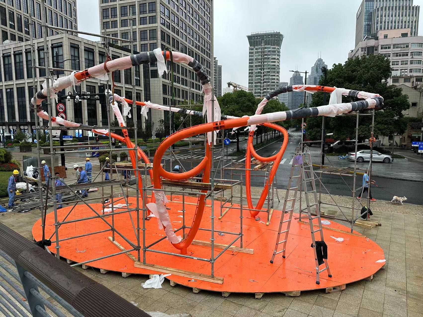

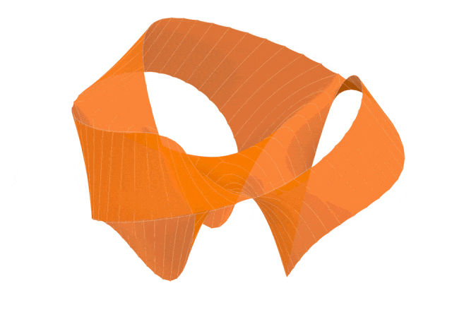

  • The edges of the Mobius strips are deepened into a curved steel pipe that is subjected to bending, shearing, and torsional forces. After segmentation, these pipes are CNC bent and connected by flanges. The double curved membrane is unfolded into a plane and processed in the factory, before being tied to the steel pipes on-site. The tension cables, steel pipes, and tensile membrane form a self-balancing structure together.
