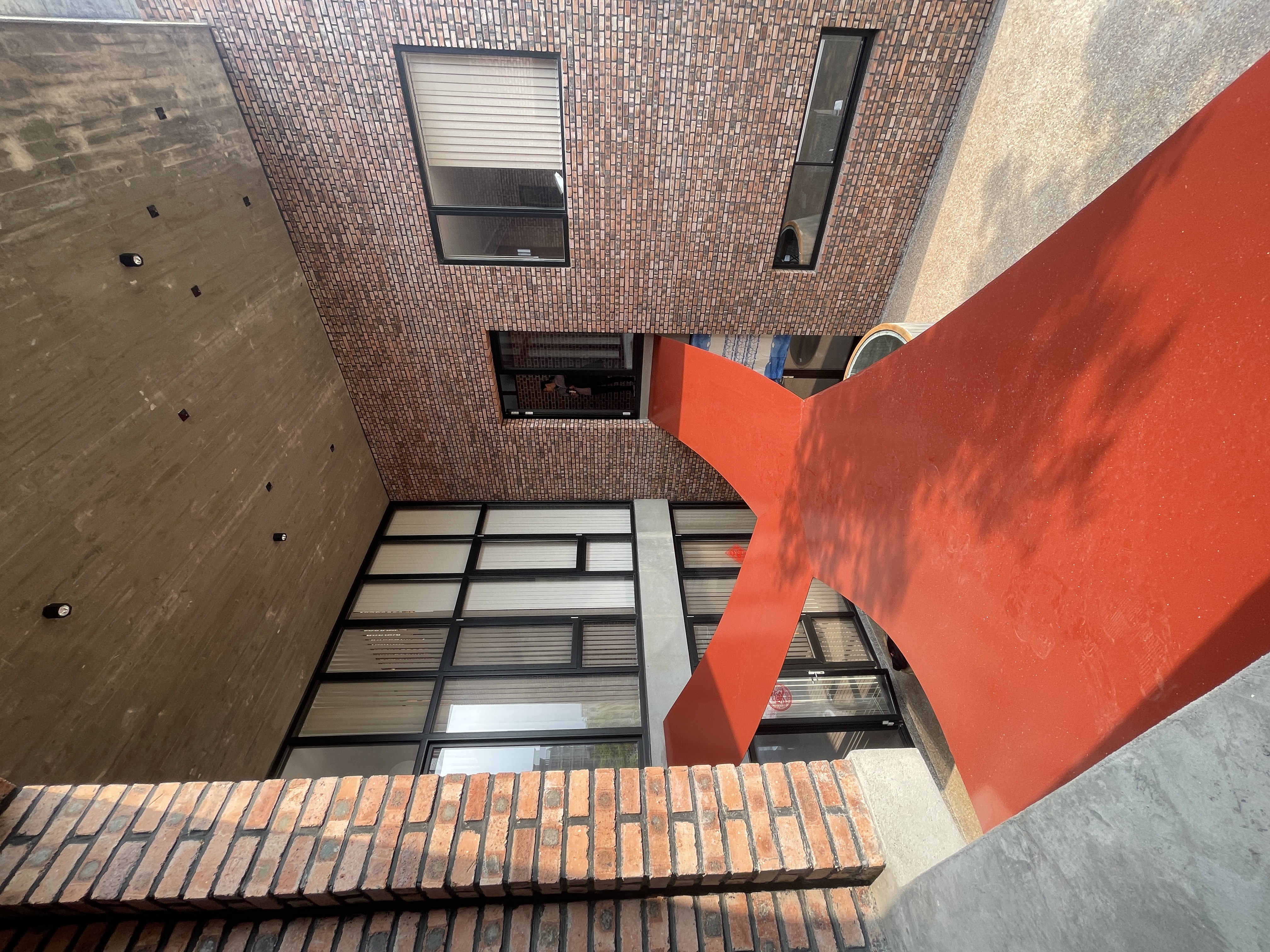

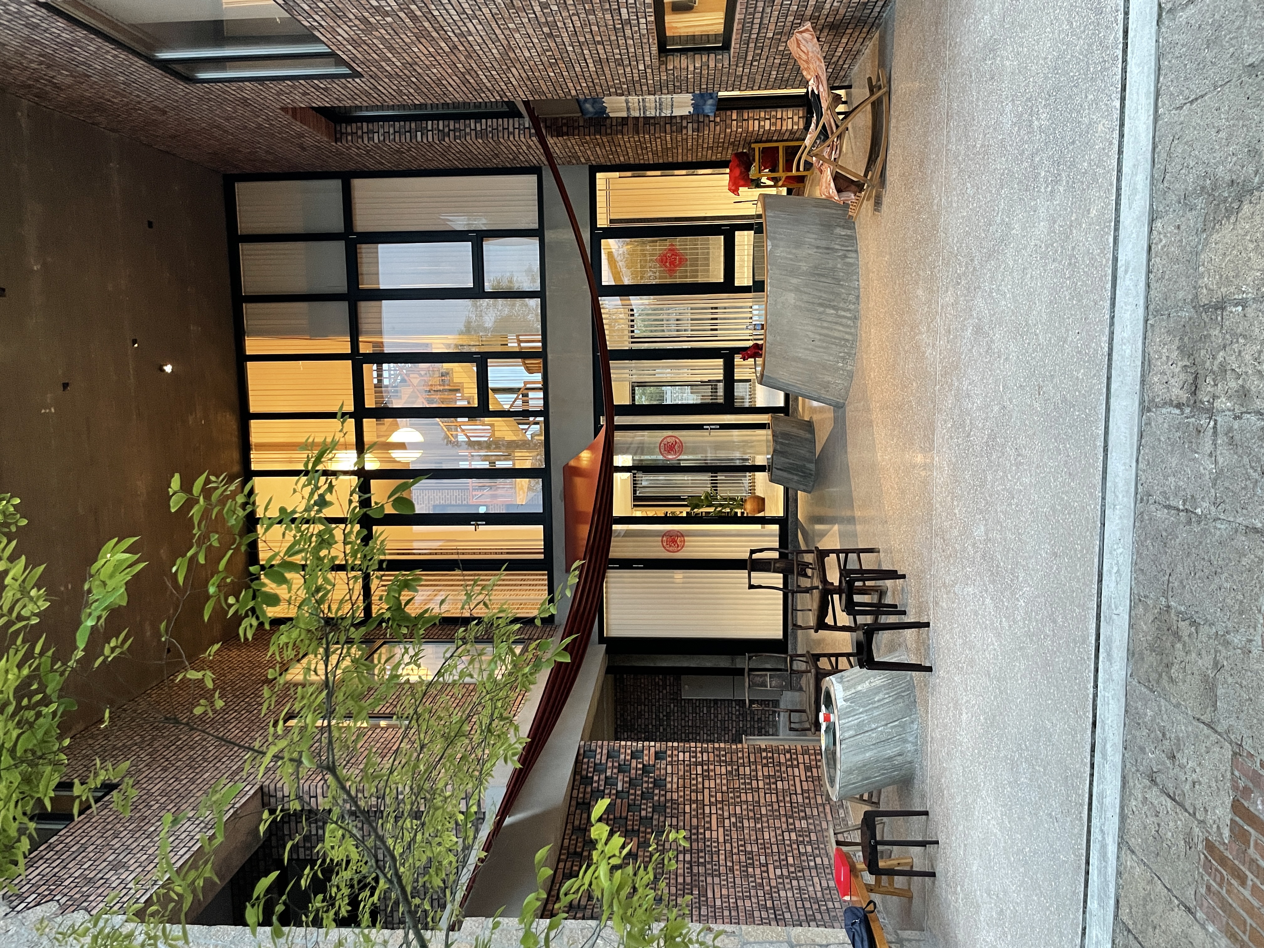

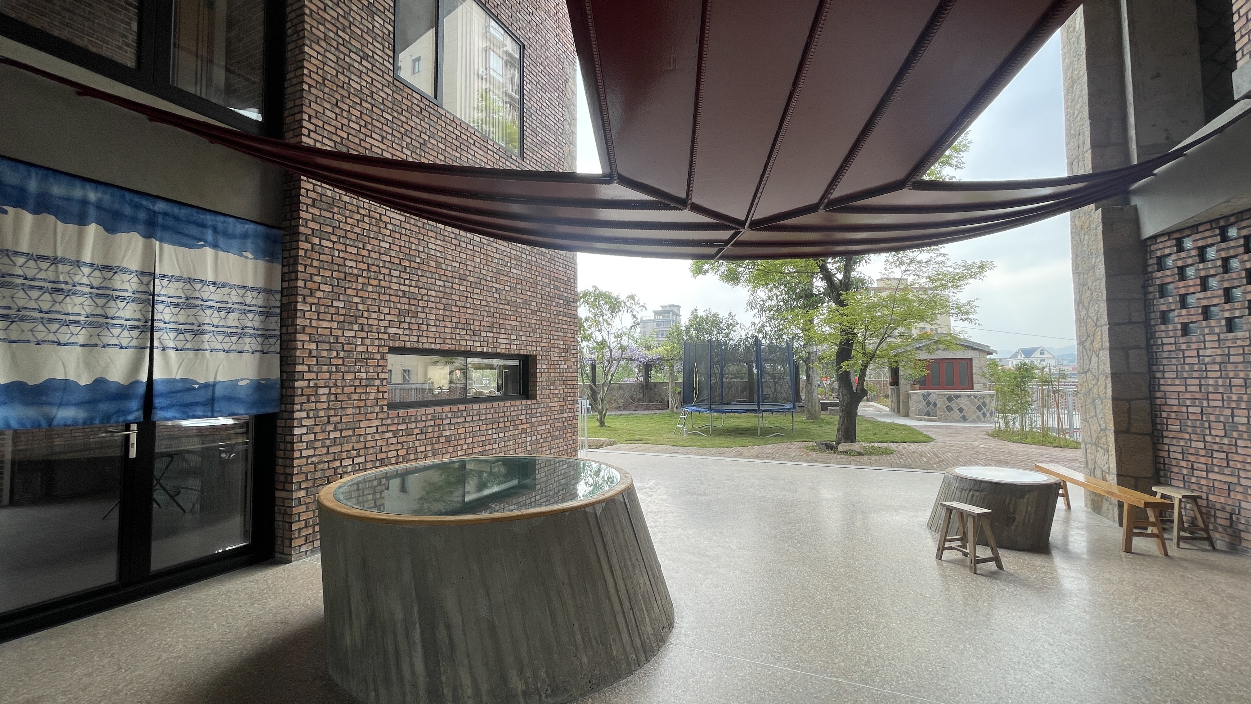

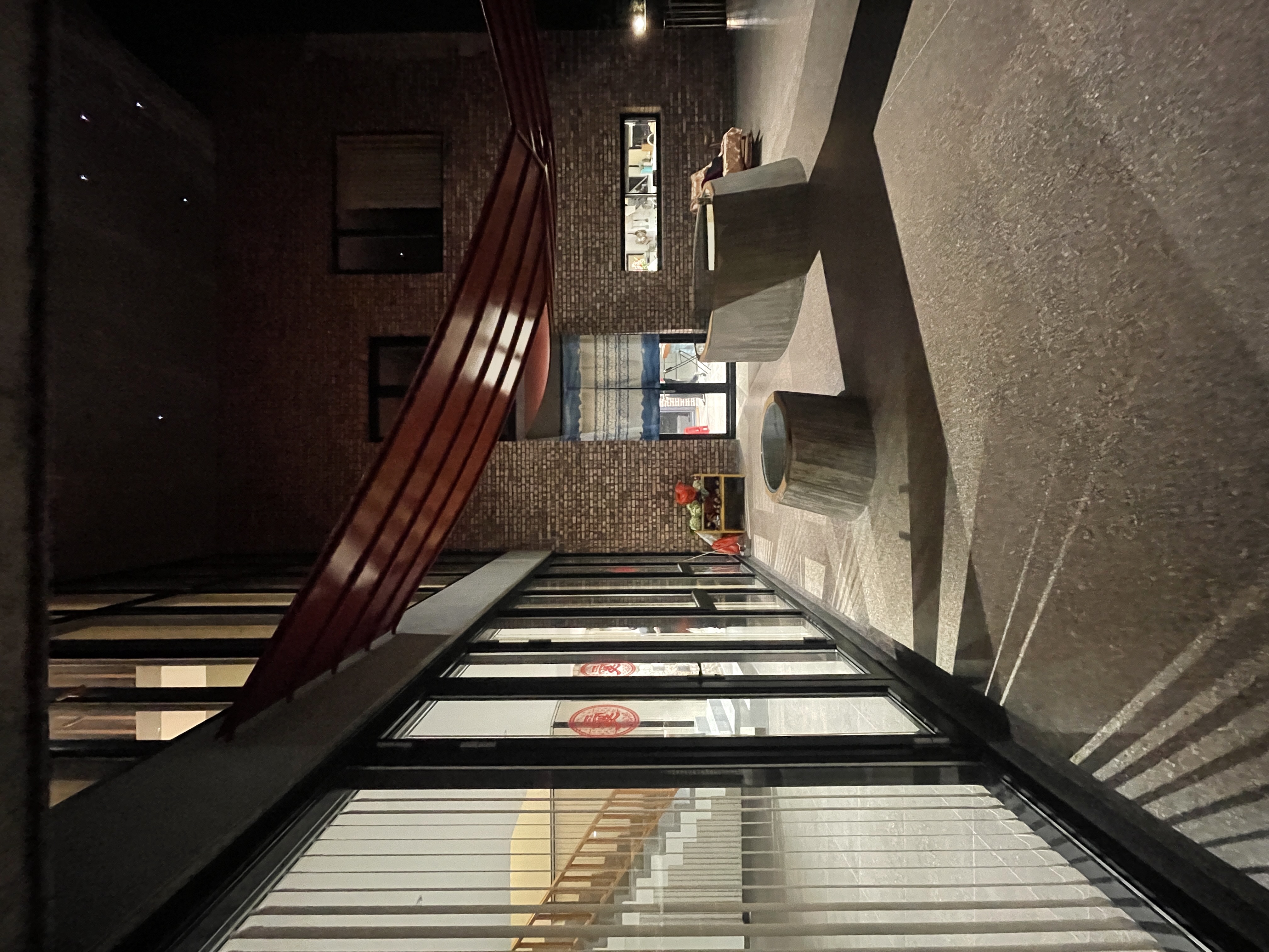

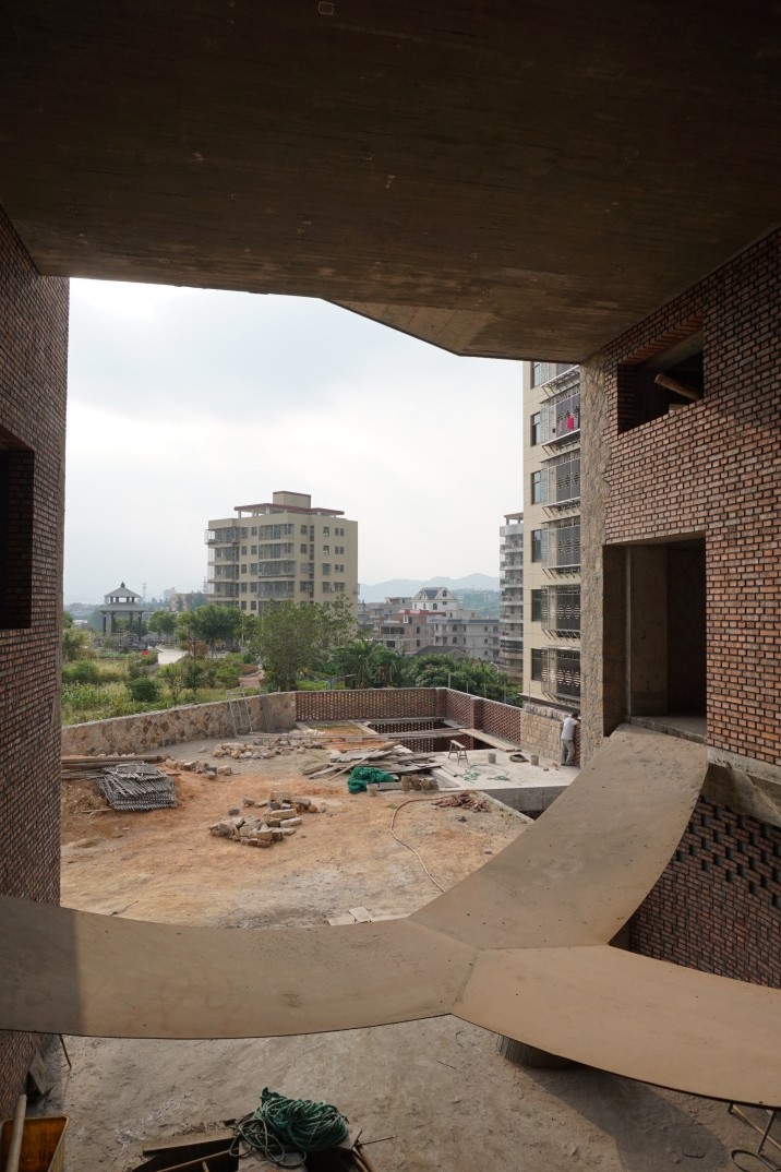

    This design requires the construction of a small bridge connecting the three rooms on the second floor in a semi-outdoor space with a height of 7,700mm. The architect hopes that this connecting bridge will bring a modern artistic sense to the building and become a cohesive gathering space. A concrete or truss structure bridge would be heavy and occupy more space. The engineer's solution enabled the initial vision of a lightweight, 6mm-thick trident bridge to become a reality. The structural design of this trident bridge integrates modern computer-aided design, industrial-era craftsmanship, and contemporary artistic elements.

    The structure of the trident bridge consists of two structural systems: "slab" and "reinforcement":
    (1) A structural system composed of steel bars welded together, with 15 steel bars distributed in the three limbs of the bridge, welded point-to-point with embedded steel bars in the floor slab. The structure is complete when wooden boards are laid directly on the steel bars. This structural system can also be replaced with other components, such as steel cables.
    (2) A structural system in which embedded steel bars in the floor slab are welded to the steel plates of the three limbs, with a minimum welding length of 30mm between the steel plate and the embedded steel bars in the floor slab. This is also a complete structural system, so the trident bridge has a double-insurance structural system.
    (3) If there is the ability to apply prestress on-site, it can increase the rigidity of the bridge, but applying prestress is not a mandatory option. (4) The curved surface of the bridge deck is cut from a spherical surface, and this non-developable curved shape enhances the structural strength and rigidity.
    In summary, the 7m span and 2.5KN/㎡ live load-bearing capacity of the bridge are completed through the collaboration of five 25mm diameter steel bars at the bottom for tension resistance and 6mm thick steel plates at the top for compression resistance. The lightweight effect of the trident bridge is achieved by applying prestress.
    The steel plate is cut near the floor slab, leaving a 5cm gap, honestly revealing the five steel bars and expressing the characteristics of the material through this detail.

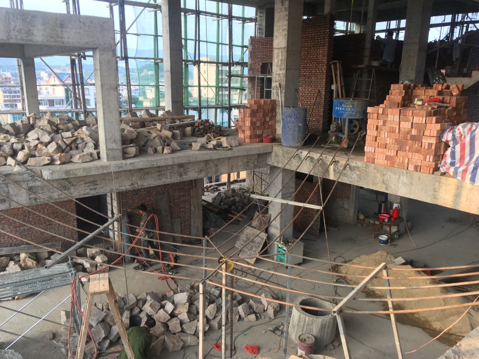

    1.4 Construction Method
    The design strategy targets the typhoon-affected coastal villages in this area. The client invited local retired shipbuilders to weld the bridge, completing the form-finding process during construction and applying prestress before installing the steel plates by temporarily suspending weights on the steel bars.
    Common hand chain hoists were used to apply the prestress, with 1.5 tons of prestress applied. After cutting the center bracket for a while, the lowest point of the center steel plate rebounded less than 20mm.
