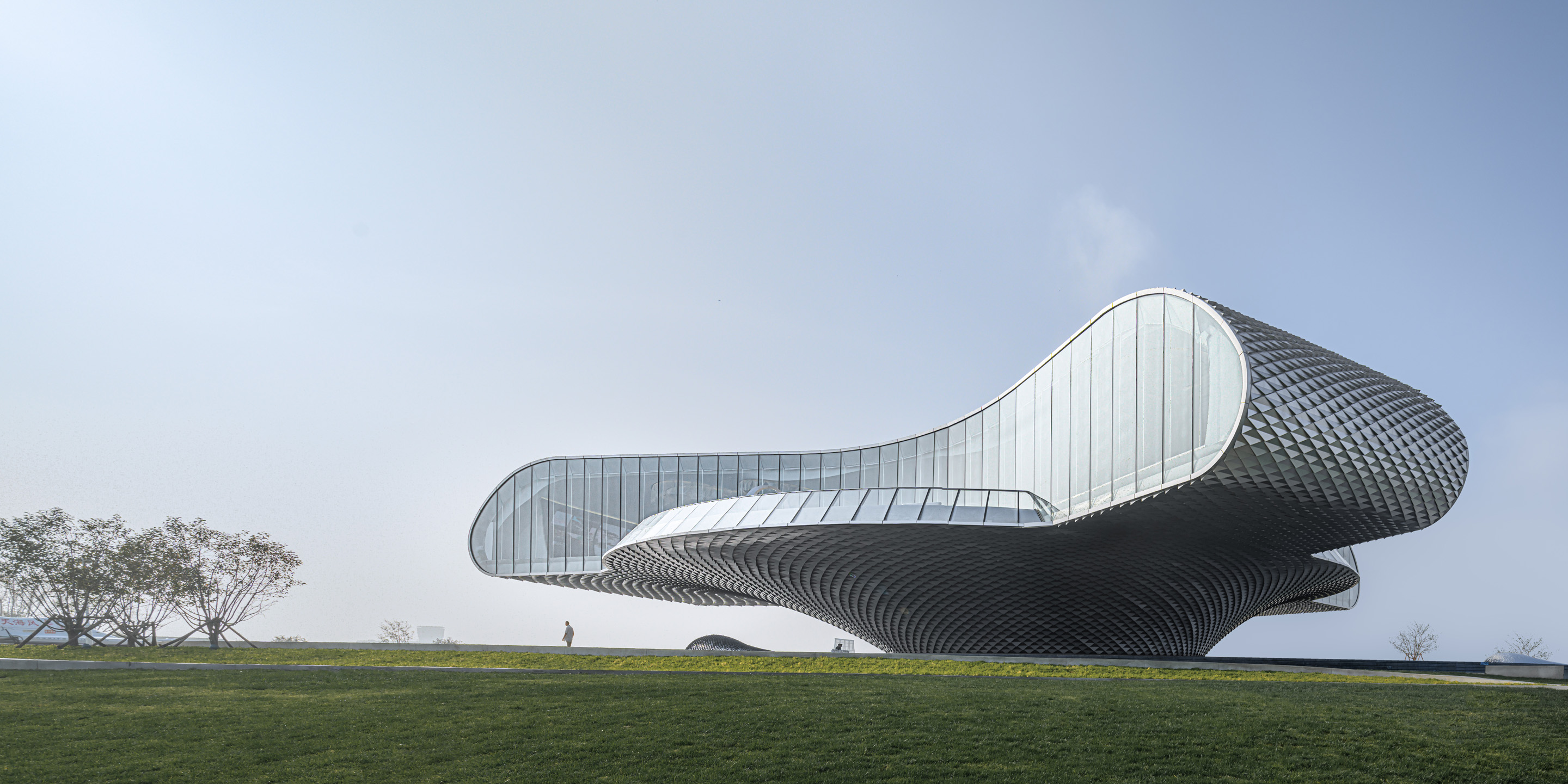

Figure 1 – Lateral view ©CAAI

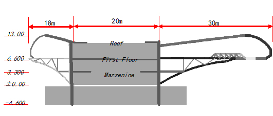

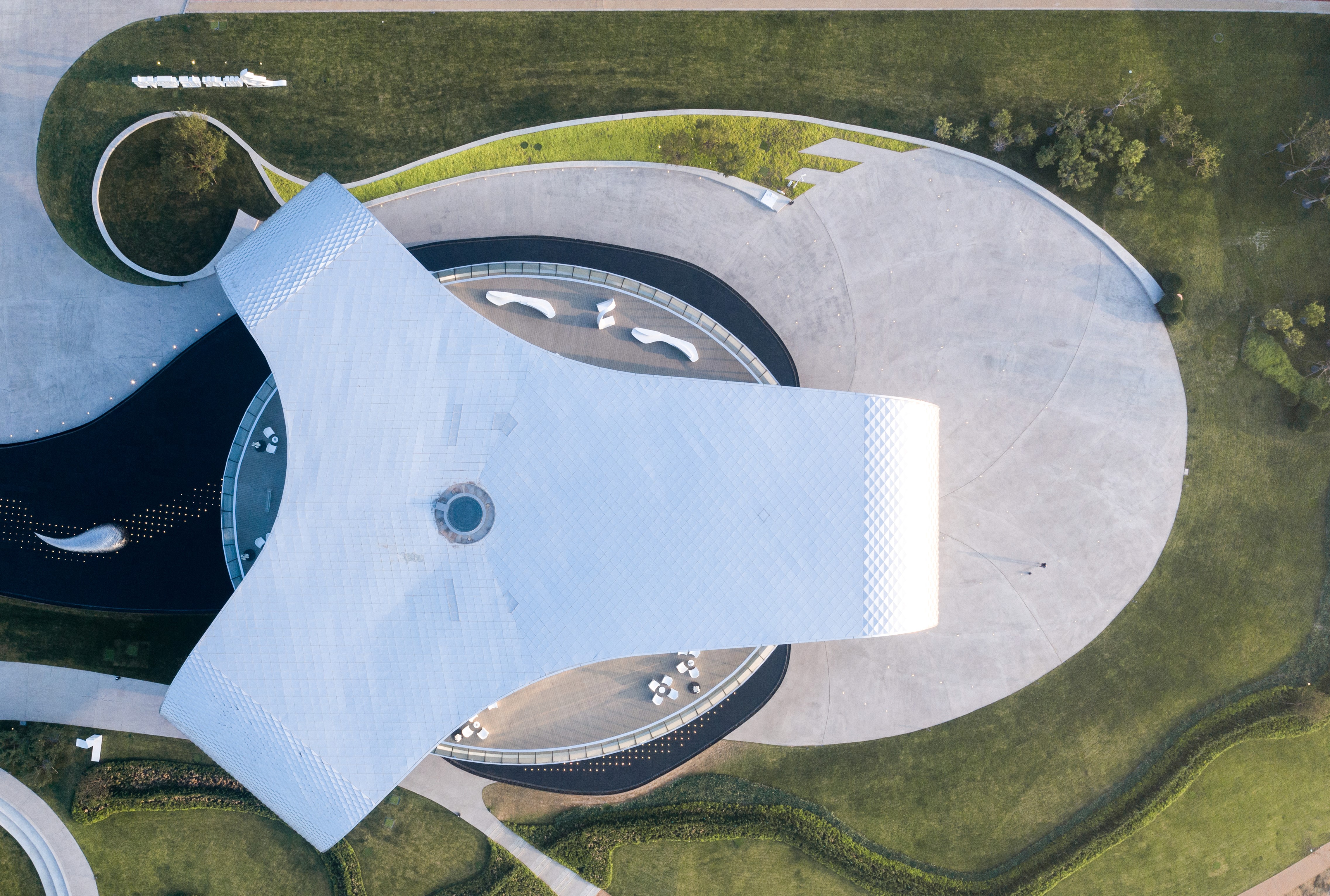

The roof forms a three radial star in plan. The legs of the roof star cantilever from the central reinforced concrete core with one 18m-wide leg cantilevering by 30m and other two 18m and 12m-wide legs both cantilevering by 18m. The oval first floor plate is 50m by 42m in the long axis and short axis respectively. The first floor plate also cantilevers from the central concrete core. The concrete core is 20m in diameter and formed by 600mm thick core walls.

Wave Art Museum
Figure 2a Sections ©Lacime

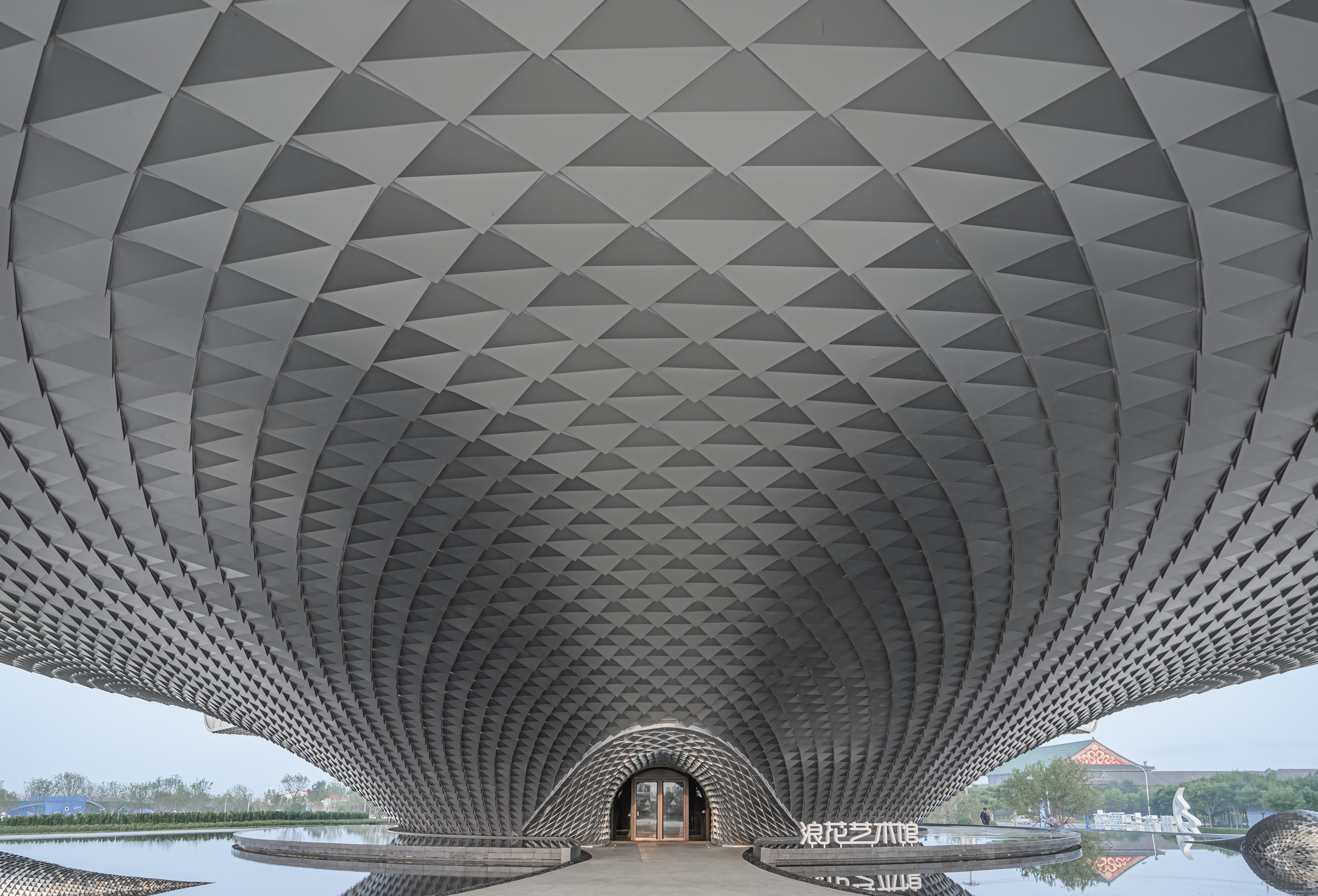

The building impressed visitors by its double-curved surfaces covered by scale-like aluminum plates and full height glazing.
Wave Art Museum
Figure 2b - Facade ©CAAI

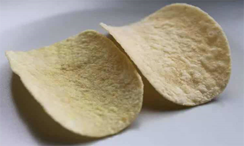

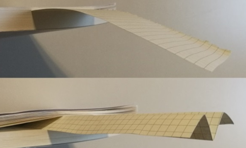

Form is forces. The 30m cantilever roof is achieved by its double-curved shape. When the Gauss curvature is not 0, the surface will not be able to be flattened. The moments due to the loadings will then be resisted by the tension and compression axial forces in the surface. The Gauss curvature of this roof is negative, therefore it can utilize its natural shape to resist all loadings. The middle beams are set lower than the side beams by 2.4m. Although the physical beam thickness is only 600mm, the real structural thickness from an engineer’s eye is actually 2.4m, which is 4 times of the physical thickness. If we compare the Lay’s chips to Pringles chips, the former is more easily broken while the latter is not. The thickness of both chips is more or less the same, but Pringles chips are made to a surface with non-zero Gauss curvature. If we consider a paper as a structure, by not changing the paper thickness, the stiffness of the paper can be massively increased by folding the paper and transform it into waves. The 30m cantilever roof uses the same theory.
Wave Art Museum Wave Art Museum
Figure 3a – Lay's chips (left) vs Pringles chips (right) Figure 3b – Physical thickness (top) vs Structural thickness (bottom)

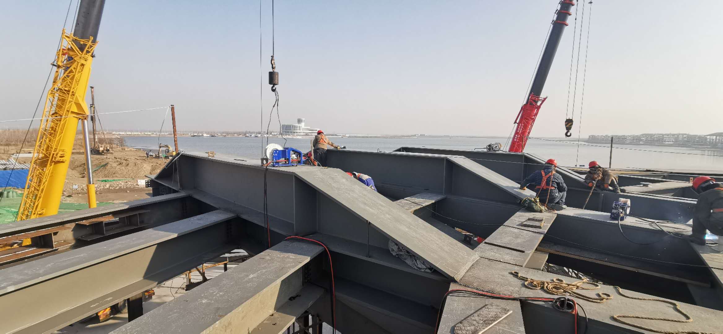

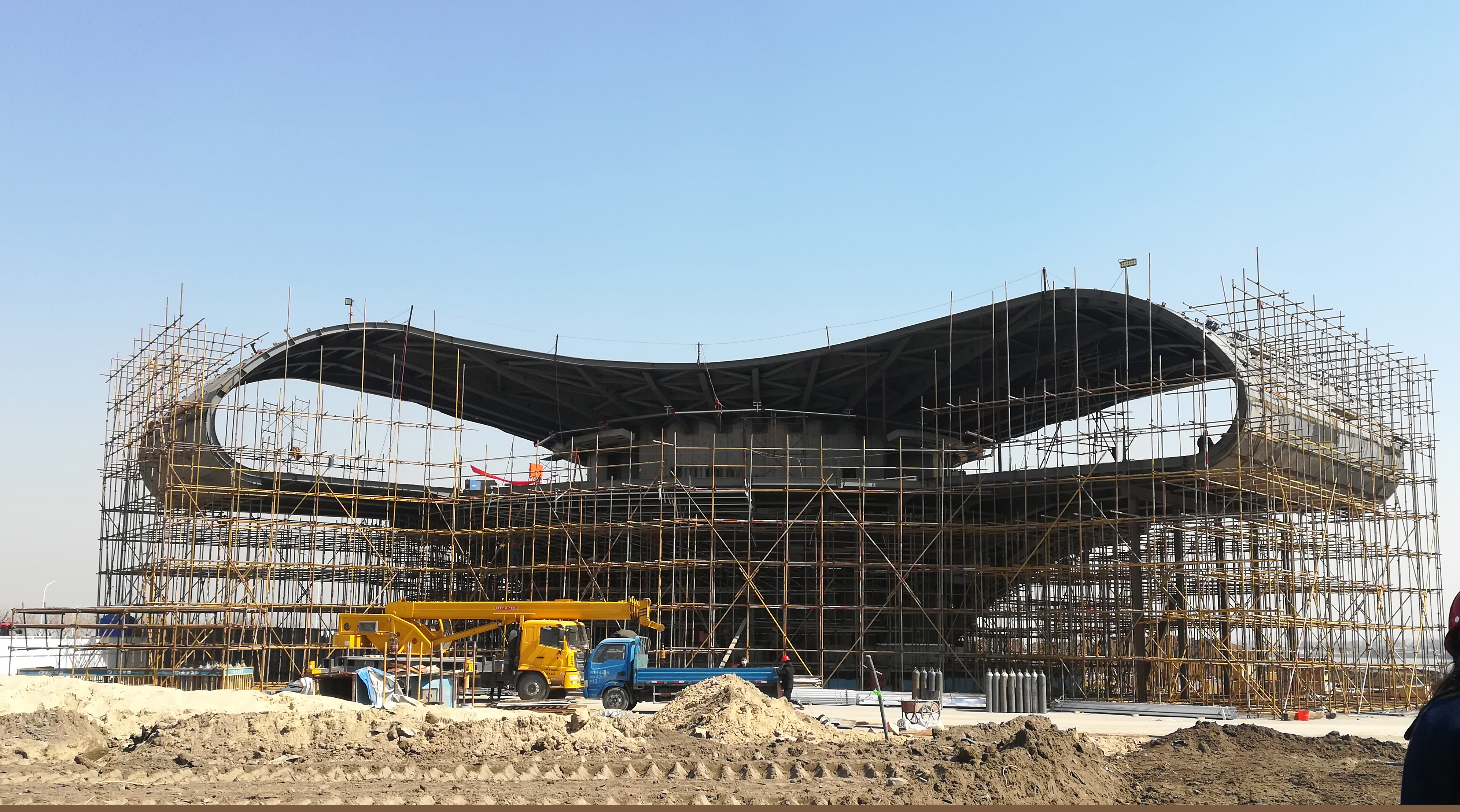

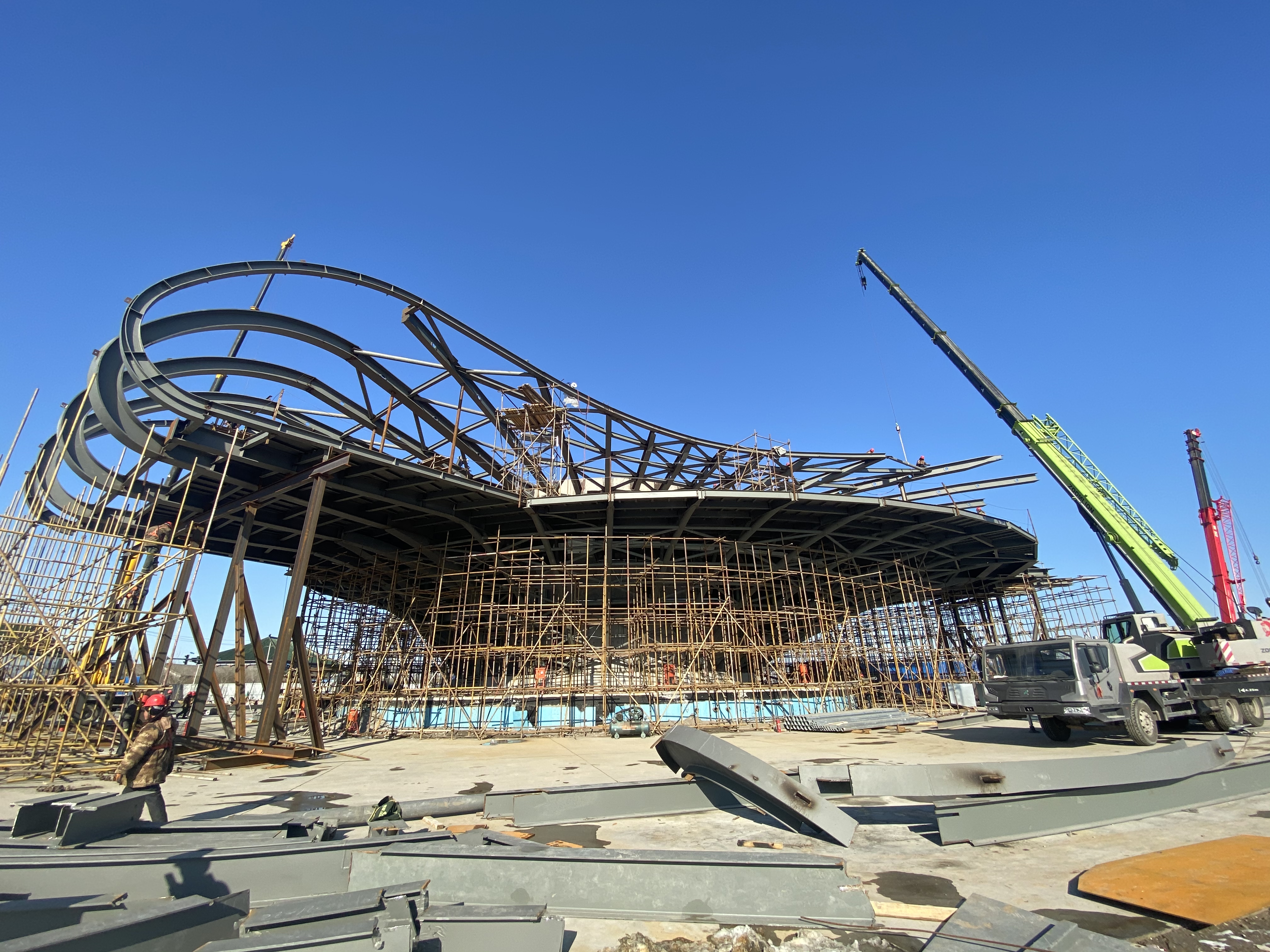

For the 30m cantilever first floor plate, the 20m cantilever closer to the core is achieved by truss and the last 10m cantilever is achieved by upstand beams which can be hidden in the furniture. Three tuned liquid dampers are installed on the upstand beams to reduce floor vibrations and improve the experience of the visitors. The beams are also fabricated considering pre-deflection under dead load and half of live load. Ring beams are provided to tie the radius beams and increase the structural integrity. Steel plates with fins are used for both roof and first floor slab. It works as a membrane to further enhance the structural integrity.
Wave Art Museum
Figure 4 – Site photo ©Shimao
Wave Art Museum
Figure 4a – Upstand beams ©Shimao

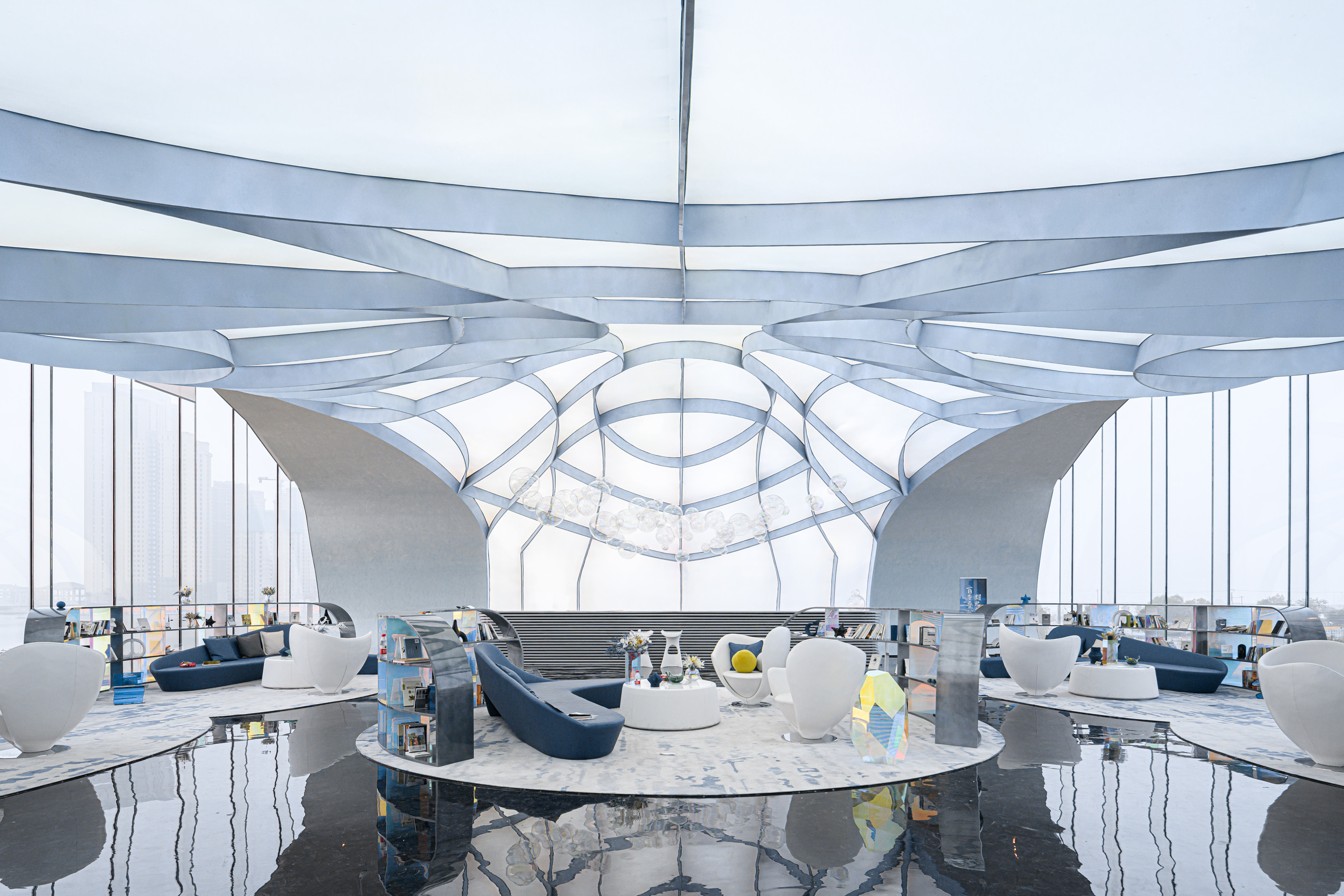

Figure 6 – Interior view ©CAAI
